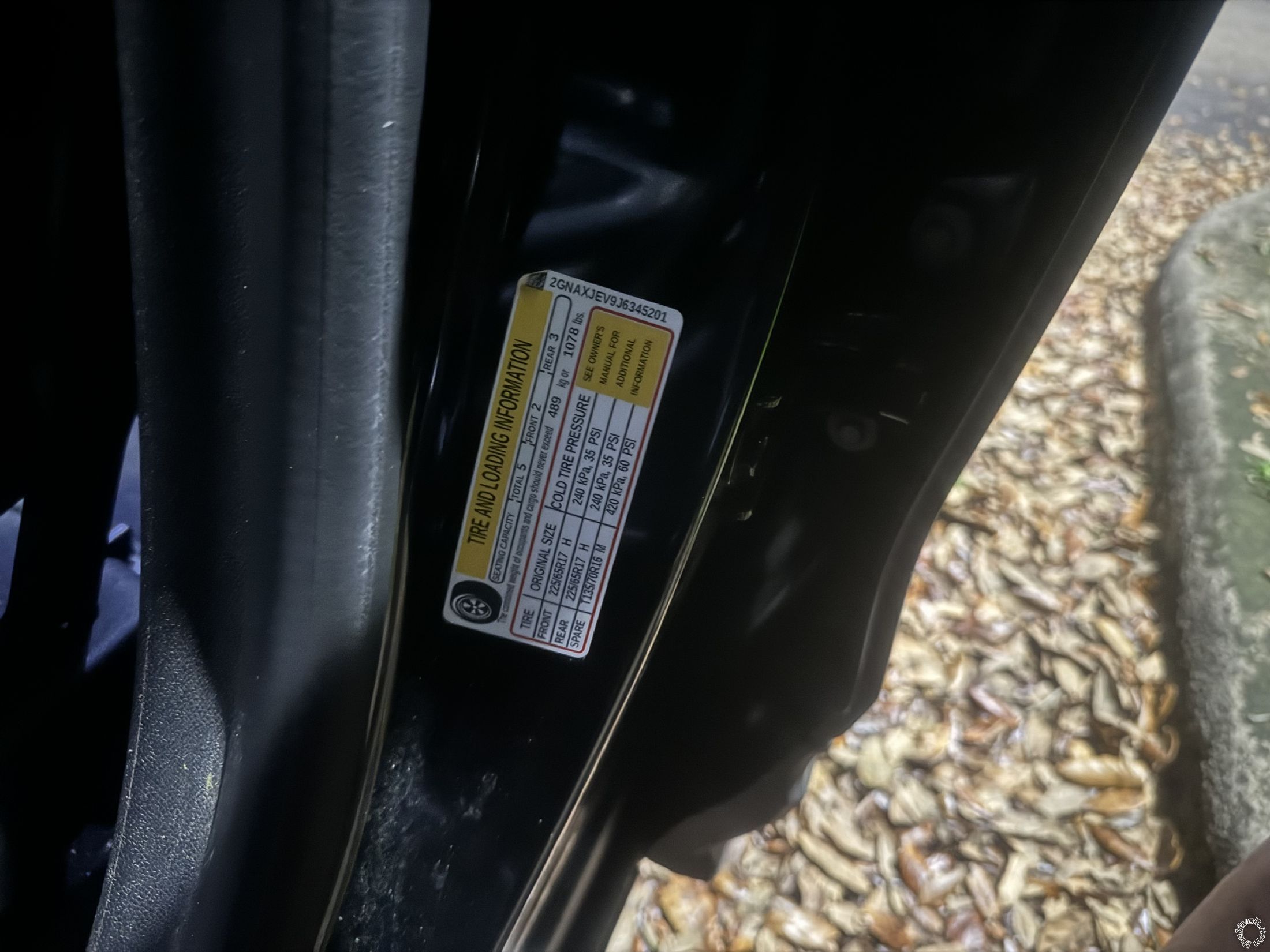

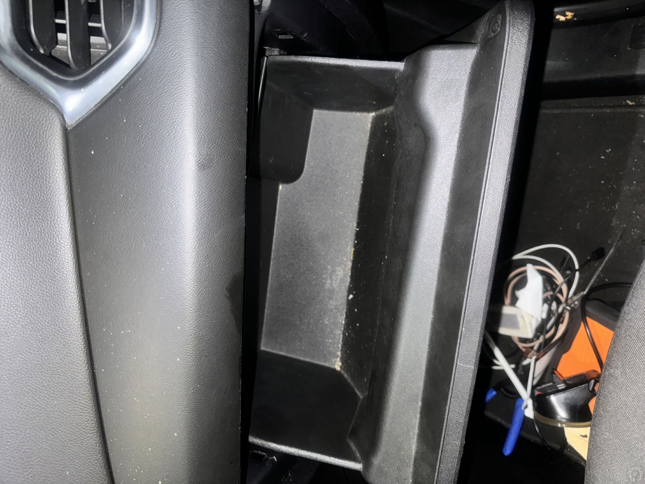

Hi, thank you i looked in my glove compartment and there is no sticker. removed glovebox and all no sticker and this on sticker on door.

Is there a QR code on the vin sticker? It will be either on the drivers door or on the bottom of the B pillar.
