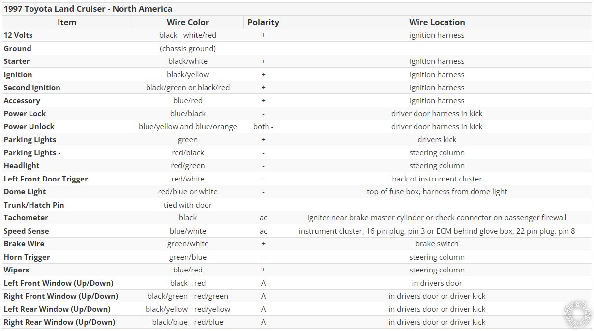

johnny12v
Joined: May 08, 2024
Posted: May 11, 2024 at 7:49 PM / IP Logged Link to Post Post Reply Quote johnny12v
hope this helps, its all the info that was posted on it
1997 Toyota Land Cruiser, Viper 5706V Wiring - Last Post -- posted image.
