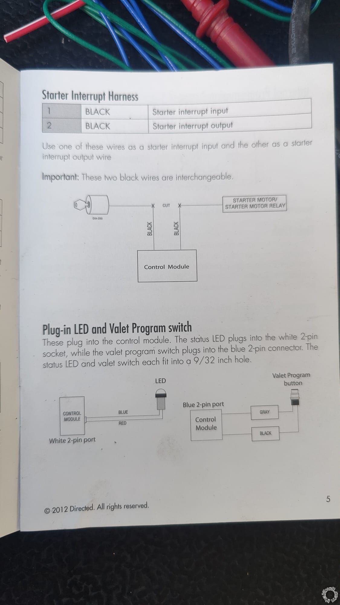

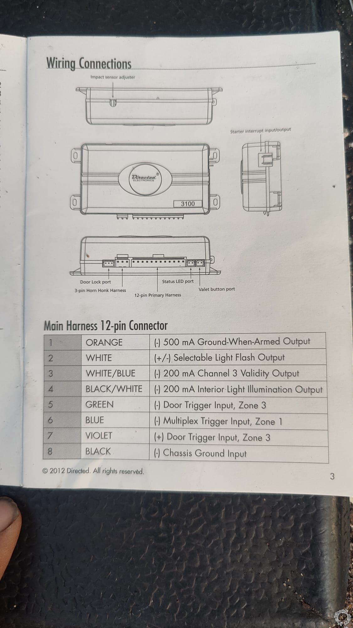

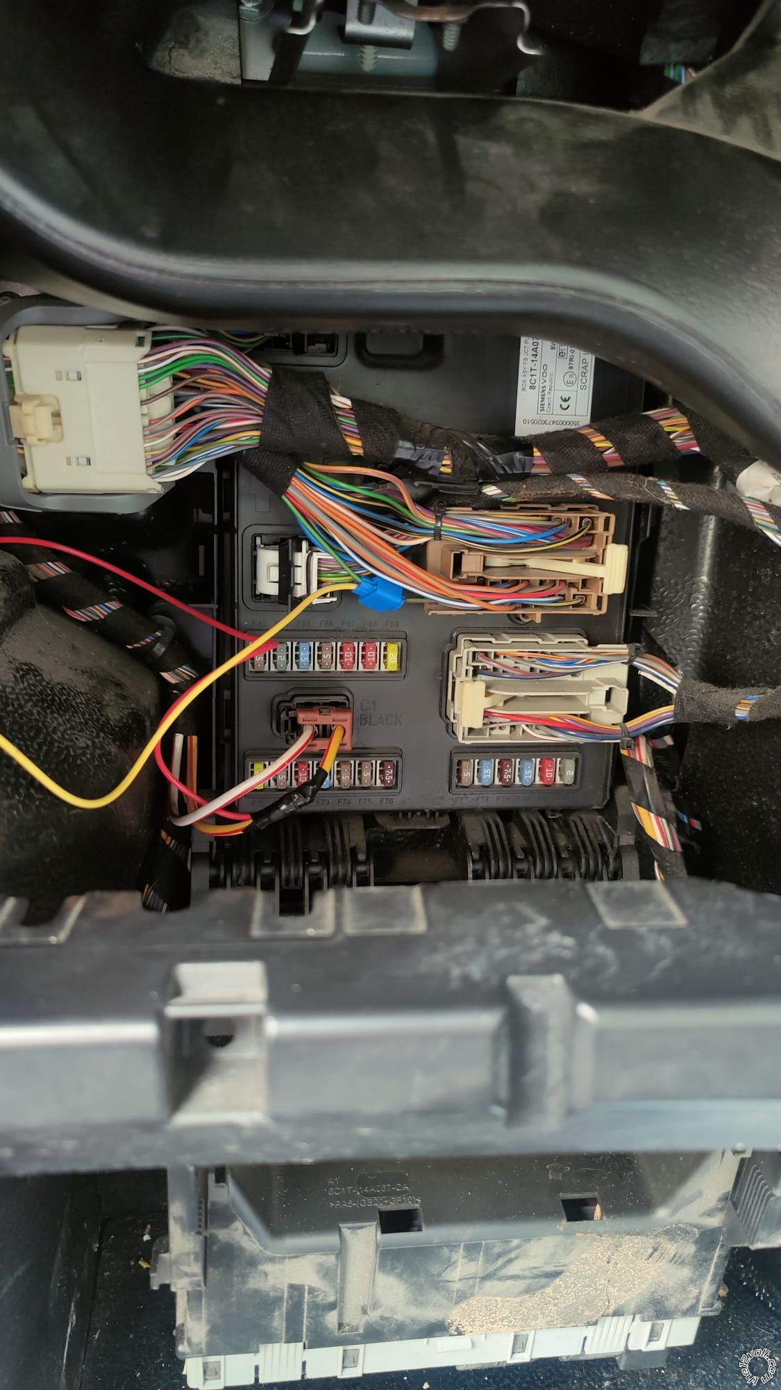

Can anyone please offer any advice on installing an Avital 3100 on a Mk7 2007 Ford Transit here in the UK ?
I have connected in the red (constant +12v), Black (Ground) and Yellow (ignition live) wires. I need to connect the door pins, lock, unlock wires etc. Can anyone point me in the right direction to find the correct corresponding wires on the Transit ? I have connected the current wires by the BCM module.
Thank You !

No luck here. We didn't have those this side of the pond until much later. Sorry bud.
