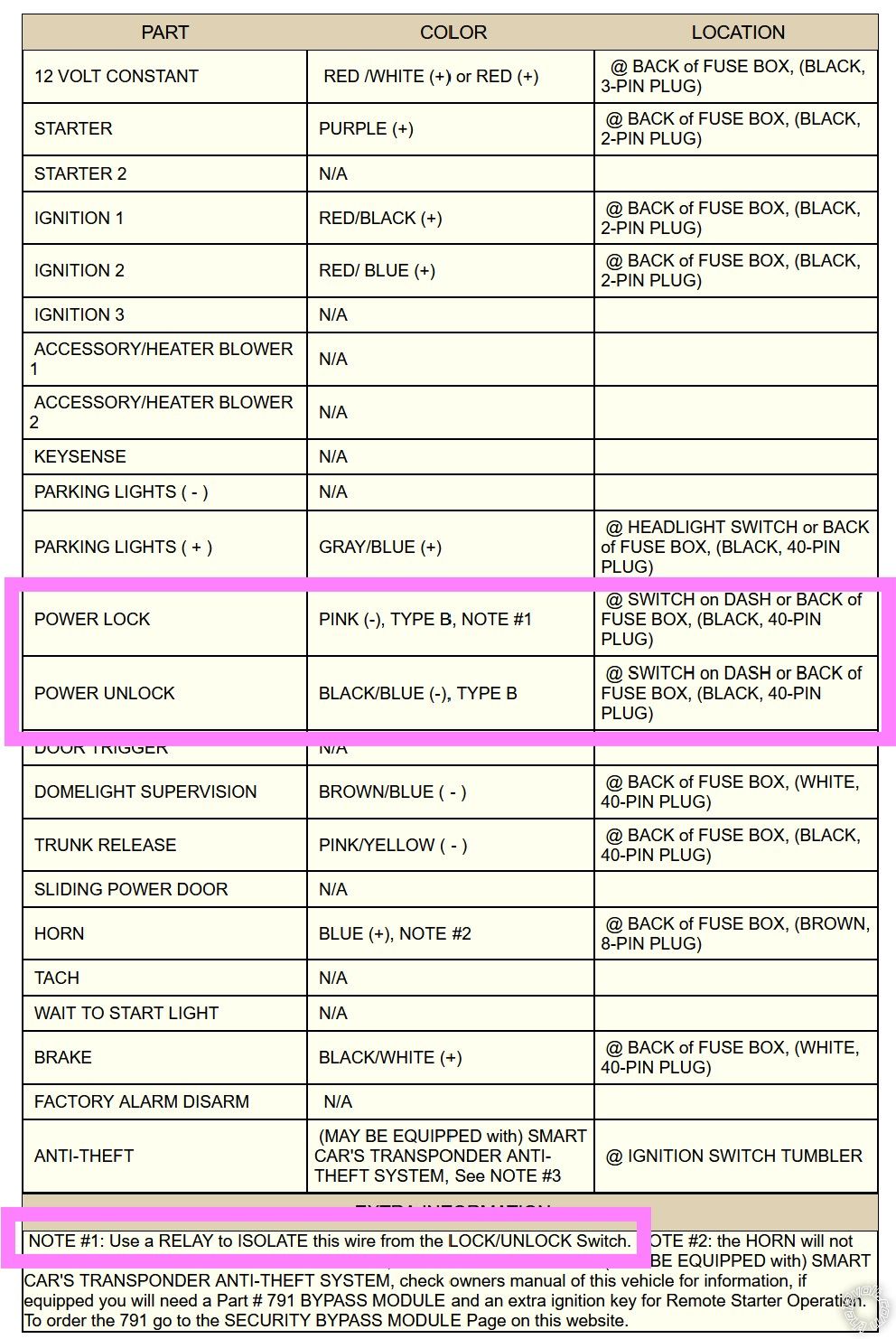

Hi,
Could someone explain what the notes highlighted in the box means..."Relay to isolate wire from lock/unlock switch".
Relay To Isolate Wire From Lock/Unlock Switch? - Last Post -- posted image.
I'm just learning so would appreciate the help.

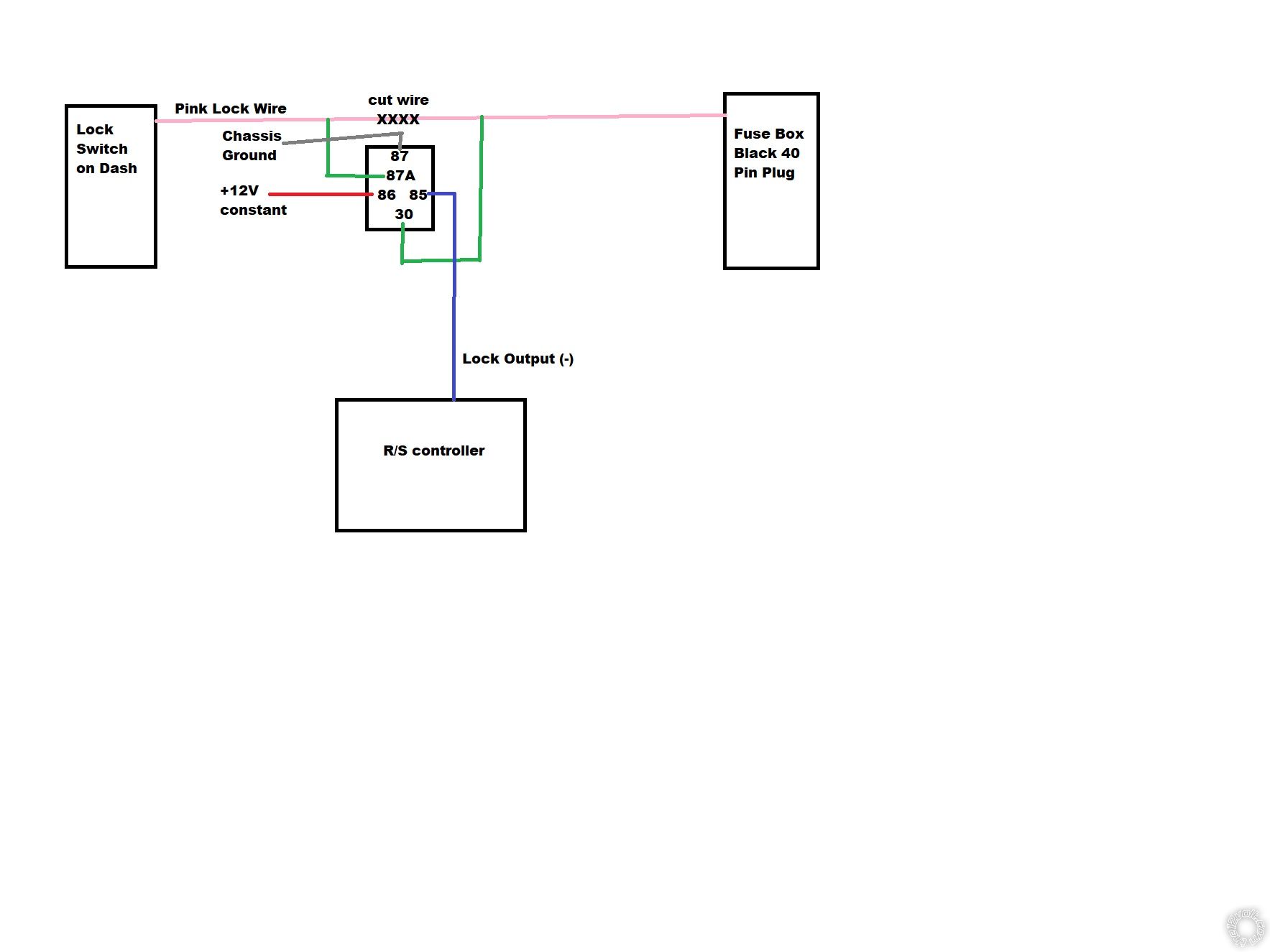

What is the year/make/model vehicle? Here's an example of a relay isolating diagram, but probably not the one you need:
https://www.the12volt.com/relays/relaydiagram3.html
Platinum - Posts: 7,828
Posted: March 13, 2025 at 6:55 PM / IP Logged Link to Post Post Reply Quote kreg357
The relay is used to isolate the vehicles lock switch from the aftermarket devices (-) Lock output signal.
Here is a diagram for the added relay.
Under normal operation the vehicles Lock signal passes thru the relay, Pin 87A to Pin 30. With a aftermarket Lock signal output, the relay is energized. This opens the normal vehicle Pink Lock wire path through the relay and puts a (-) on the vehicles Lock wire going to the Fuse Box connector only.

Thanks Kreg and Lee for taking the time with the diagrams and explanations; really helped my understanding.Relay To Isolate Wire From Lock/Unlock Switch? - Last Post -- posted image.
