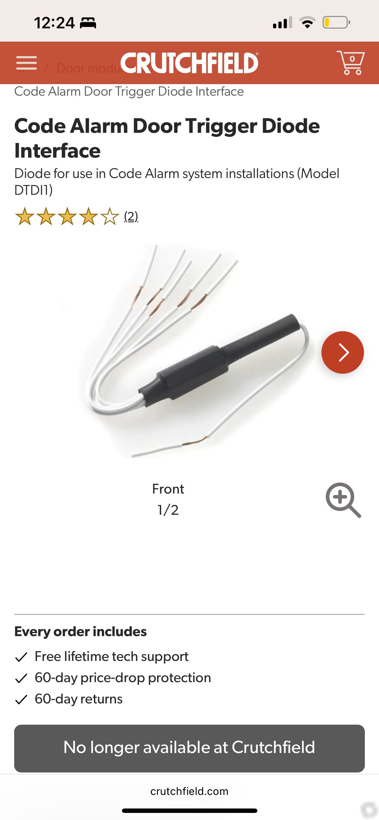

I have a 2019 Nissan frontier four door truck. I have the viper alarm 3305V. Each of my four doors has a door open trigger switch.
Is the DTDI1 door trigger diode interface all that I need to make the door triggers work correctly with my viper 3305V alarm?
Thank you!2019 Nissan Frontier, Viper 3305V Alarm - Last Post -- posted image.

Pretty much. Or you can go to the a pillar and pick up a straight negative trigger there.
