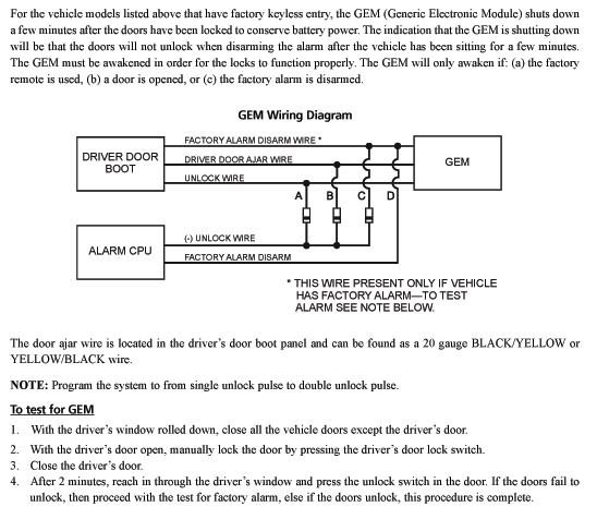

on Ford Cars 7 trucks you have to wake up the gem module if you want to add an audiovox keyless entry unit.

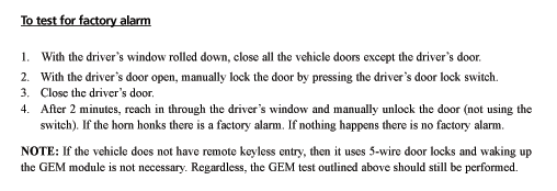

Try this procedure to see if your car's doorlocks go to sleep
Keyless entry on 2003 Taurus - Last Post -- posted image.

nighthawk2k
Copper - Posts: 116
Joined: June 02, 2003
Posted: January 02, 2004 at 11:05 PM / IP Logged

nighthawk2k
Copper - Posts: 116
Posted: January 02, 2004 at 11:06 PM / IP Logged
Keyless entry on 2003 Taurus - Last Post -- posted image. try this as well
