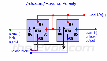

I have an actuator that uses a simple postive and negative to extend and then the negative and positive have to be reversed to retract it. If any of you can help figure out how to do this with a switch and relays that would be great. Thanks for all the help

2 relays will be needed they will reverse polarity for you!Actuator Help - Last Post -- posted image. Add your switches and pulse the relays with a ground from the switch you add!

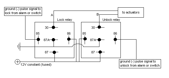

this diagram only applies if the "trigger" wires from the alarm provide a pulsed ground (-) to lock/unlock. If they provide a pulsed positive (+) instead, you will have to ground the opposite 85/86 terminal to allow the relay to work. Actually, my alarm allowed me to use either pulsed (-) or (+), I just chose to use the (-).
