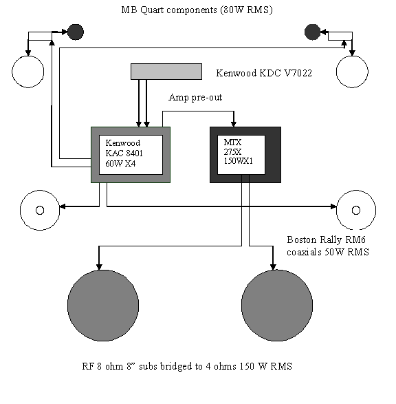

sorry that diagram i posted is wrong. I meant for the sub output on the 3xs to go to the 4 channel amp instead of the mtx amp you currently have and the rear output from the 3xs to go to your mtx amp.

Now as I said earlier one of the two preouts I have is non fading (which now I understand is good for subs etc which u dont need to fade) SO can I still use this Audio COntrol 3is and still be able to fade between the front MB quarts and rear Boston RM6 coaxials?

I'm pretty sure that you can switch the rear preamp output on your deck from fading to non-fading.

Yes the HU does have option of chanign from non fading to fading, just checked the manual.
Question: the rating on the subs is 150 RMS each and that of the MB quart is 80 RMS .please correct me if I am wrong, I got this info from
http://www.mbquart.com/2003/en_US/products/prod_detail.asp?isArchive=true&cat=&series=q%20series&strt=1&model=QTC+25
and you suggested a 50W X4 amp. Wouldn't the speakers perform better if I use a higher RMS amp?

How about this set up? I was trying to eliminate the cost of Audio controller 3xs suggested by customsuburb and also I hooked up the 275X to the subs, bridged at 4 ohm to get 150 W
Please comment/suggest.
