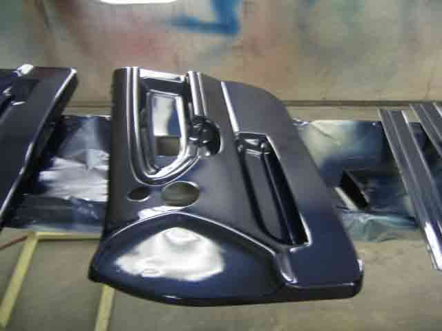

Ok so i got a few questions....   I have all my door panels in my bmw 325i painted with automotive paint and clear coat..  primed before the base was layed..    so after a while i noticed cracking... HMMMM FU_K!!!!    well  n  e ways sh*t happens..  so i wanted to know about this chem called "GEL COAT"  i have used fiberglass cloth/matt  and res and hardner.. i understand all concepts.. i just wanted to know how gel coat works were to get it.. and its sanding properties..

Gel Coat - Last Post -- posted image.
this is what primer and paint looks like but its not very durable..
