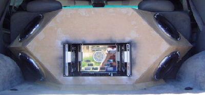

Heres the pic of the box.  Any ideas will be tried and appreciated.  Thanks

Is the amp rattling against the box?

What kind of glue was used when building the box? You may also try carpeting the box. Did you use nails or screws?

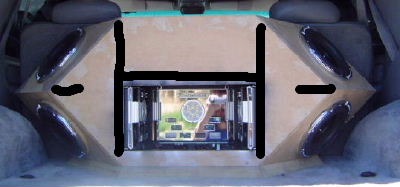

Also it looks pretty huge for 4-10's.  Is it ported?  In general 3/4" MDF won't resonante to speak of, but it does need to be braced internally to prevent flexing.  I'd bet you need additional bracing, especially with a strange geometry like that.  Also, be very sure the enclosure is not flexing at all where the amp is mounted or you can very easily destroy the amp when it's mounted on a large wall like that.

#2.  I used liquid nails for glue, and did both screw and nail the joints.  I prefer to screw all joints but because of geometry reasons some were nailed for added strength.  Carpet may not be an option, since the customer wants to finish with granite texture paint(you know the grey crap with black and white flecks?) But I considered carpeting the insides of the enclosure.
#3.  It is not as big as it actually looks, the box is only 13 inches front to back, and where you see the amp(s) it is actually sunk into the box clear to the front, and there is 3 amps in the hole.  One on each side, and the one you can see mounted against the back of the front wall...mind boggling description I think.  there are braces running front to back right above the amp space both horizontally and vertically at each side of amps. Also braces ran from rear point of diamond to front wall on each side.  Black lines indicate braces.
