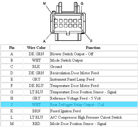

Anyone know how to hook up a remote starter to the defrost in a 1999 Chevrolet Silverado?

i hook up the defrost wire....so someone out there does....what i usually do is wire the defrost off of one of the extra channels and use it when i need....it is easy to figure out ....go to the defrost switch and determine if it is negitive trigger or positive.....if it is negitive wire up a relay for negitive trigger....if it is postive wire it 5wire to respect to switch and keep from burning it up.  also what color did u use for factory disarm?

Rear defrost is (-) negative trigger @ the back of the HVAC controls.
