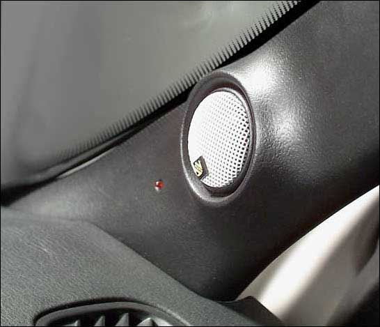

How to make tweeter in pillar? - Last Post -- posted image.
I want to mount tweeter in a-pillar.

very simple task......make a mdf ring or if u have a plastic insert that it came with......take ur a pillar off position ur ring where u want (use something to secure the ring dowel rod pieces of mdf) stretch fleece or a type of fabric over the entire a pillar apply resin might want to apply some fiberglass matt for extra strength........sand bondo sand paint or leather/vinyl it

no once u do that panel is done with.......now u can take a mold off the back of the panel and the front and sandwich them together and than do the tweeter but its up to u.......or u could just make a mold of the top of the piller and do ur tweeter and apply it over the original panel but ull still have to damage the panel some when u attach ur new panel to ur old

If the vehicle isnt too new, you can go to a salvage/parts yard and buy an expendable part (A-pillar in this case) for the said vehicle.  This way it doesnt matter what color it is you buy being your about to cut it up, cover it with fleece/bondo/texture and final finishing.  Just simply keep the original factory components just in case you sell the vehicle to someone too snooty and frowns at such upgrading of our preferences.
Also mentioned by YOUNGURU, was duplcating both sides of the A-pillar.  This interior component rarely supports any other objects (except the addition of a tweeter, seldom headliner).  I have often only duplicated the front of the component, not the back.  In addition, I would duplicate the mating surface, such as the cab metal/window/door areas that neighbor it when installed  This way you can construct an enclosure like component that is hollow and functional, which results in a rigid, thin, and strong structure that is empty, ready to add anything you want.  Furthermore, I have fabricated A-pillars like this, sometimes little purposely bulkier in certain areas to integrate an LCD, 4-1/2 inch speakers, switches, and the likes.  To deaden the part, just fill it with foam, expanding foam...be carefull though!!!  When applying the A-pillar by this method, keep it simple, double sided adhesive works great, or for a more precise adhesion, liquid nails...

actually if your pillar is plastic u can heat up the area where u want the tweeter with a heat gun (not too hot though) and then use a socket the same size as the tweeter and work the plastic till u have a nice flat area for the tweeter to sit flush on, then cut the hole for the tweeter to fit snug into. The only thing u have to be careful for is that u dont heat it up too much, although i suppose if the texture gets screwed up u can just sand/highbuild primer/texture spray/paint.

Another simple way to do it without using resin and matting is liquid plastic.  I have done it this way numerous times.  If there is any room behing the piller, use a whole saw and cut the hole for the tweeter to sit in.  Try to get it as far into the pillar as possible.  Secure it with hot glue, mdf pieces, whatever you want.  Simply spread liquid plastic (sometimes called "rigid filler") around the gap of the tweeter mount/mdf ring and start "sculpting" the tweeter rise.  The liquid plastic dries very quickly and you can add about 3 layers until you get a uniform ridge.  Scuff the rest of the sail or a-piller, texture and die.
