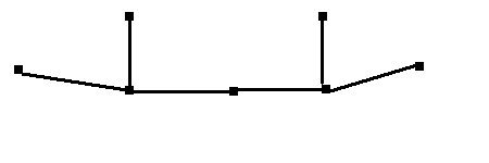

j0ne, parallel wiring is all same-polarity points that are connected together with wire or other means of connection.  You can look at it as immediate, or instant, connectivity.  There is no current flow described in the following illustration, as all of the points are of the same polarity:
Capacitor? - Last Post -- posted image.
This respresents seven points of connection, all of the same polarity.  Every point is connected by wiring and there is an instant connection between all seven points.  When you have a complete circuit (both polarities in place) and all of the electrical forces are in motion, there will be current flow according to the physical laws described by Ohm and others.  You don't have to burden yourself with trying to figure out how the current will flow in this, or your, same-polarity illustration.

SI SE PUEDE! i get it...
