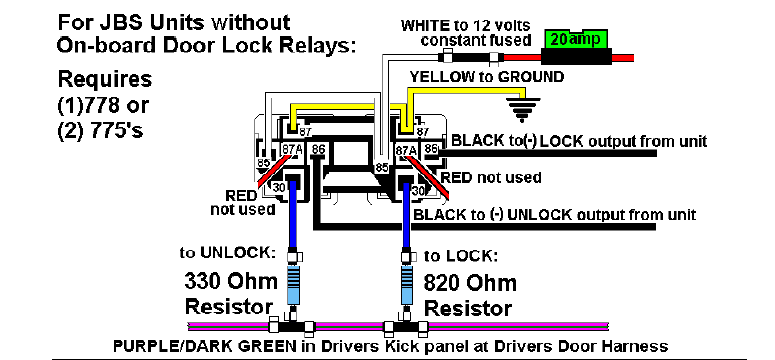

Copper - Posts: 284
Joined: January 12, 2006
Posted: July 04, 2006 at 11:56 PM / IP Logged
For the 2005 model year vehicle, to ARM/LOCK will require a (-)Negative thru a 644 Ohm Resistor and to DISARM/UNLOCK requires a (-)Negative thru a 1565 Ohm Resistor. A Single Pulse thru the 1565 will DISARM without Unlocking. Double Pulse to UNLOCK. Some units will also require 2 extra Relays Part #775 to complete this circuit, to connect, See DIAGRAM
