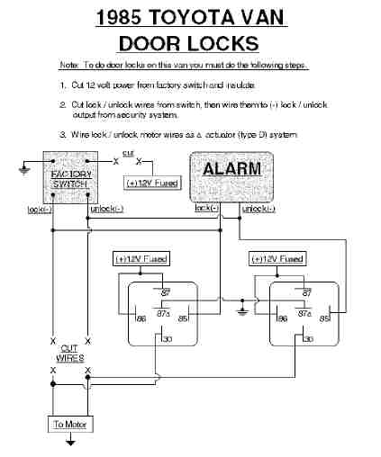

Can anyone post a wire locations / color  diagram for  a 1989 Toy 4x4  Van.  I am installing a remote start security system. I looked here and at tech services Audio vox.....but very limited info.

Power Lock  blue/red      drivers kick panel
Notes: Lock wires rest open. See Below.
Power Unlock  blue/black      drivers kick panel
