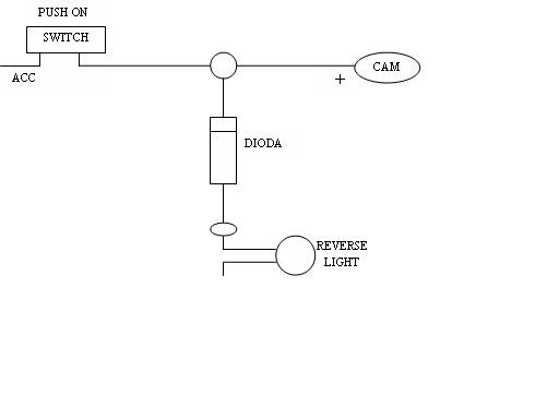

I have a rear camera that only turns on when in Reverse.
Is there away to add a relay so I can use both the Reverse and a switch to turn it on?
Thanks

you need push on switch, dioda 3 ampere. make sure when you push the switch the reverse light is not on, if the light on put the dioda opposite direction.
rear camera - Last Post -- posted image.

is there away to add a switch so that the rear cam. be turned on whiling driving. right now it will only turn on when in reverse but would like to have it on as well when driving.
