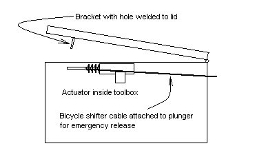

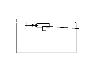

Relays aren't really required if you connect the actuators two wires to the light green and the tan/light green door lock wires in the driver's kick - be sure to syncronize lock/unlock of the actuator with the truck. Use a 5 amp circuit breaker close to the OEM wires to feed the acuators for short circuit protection.
Keep in mind that the actuators aren't waterproof nor foolproof. Figure out a way to mechanically bypass the actuator in case of failure or you'll be locked out of the toolbox.
The latches are on the outside of the box but you can't use those because of obvious security problems.
Figure out a way to put the actuators inside the box and have them latch the lid shut.
Here are some quick sketches with the lid open and closed:
Toolbox Keyless Entry - Last Post -- posted image.Toolbox Keyless Entry - Last Post -- posted image.
