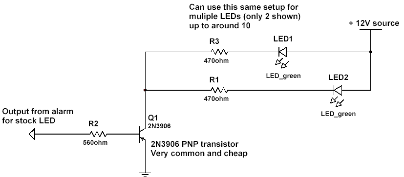

if you want to isolate it and allow for as many LEDs as you want use a transistor and some resistors the whole setup (if you bought the stuff at radioshack) would run about $2 or less...

LED's - Page 2 -- posted image.

man that picture is larger than i expected it to be.. LED's - Page 2 -- posted image. ohh well at least it is easy to read

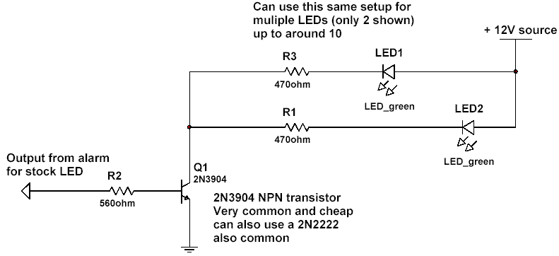

ohh man I dont know what i was thinking that is completly wrong, I ment to use an NPN transistor, sorry its been a long day.. here is the correct diagram:

All leds function as diodes as well, although they can not handle the same amounts of current and reverse bias voltages because they are not made to.
LEDs do not really operate on voltage, they operate on current. the only reason they have such a high voltage drop is because they are based on gallium arsenide, not silicon. A resistor is used to limit current because the PN junction will not.
