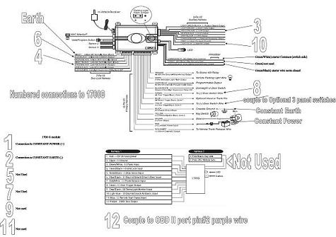

I wonder if any one has fitted an aftermarket alarm to an 06 Silverado? Someone has got to have on here as it's a great site.
I have got a Viper 3000 two way paging alarm with glass break and dual zone sensor. I have also brought a dei 1700G module to connect between the alarm and OEM electrical system.
Having looked at Both installation manuals and sorting out a connection plan, Just want a second opinion to double check. I have considered getting a professional audio/security man to install but since I am in UK, no one wants to tackle it locally(scared I guess)
I am planning on putting 3 extra Door pins on the bed cover and tailgate as not giving anyone a chance to attack it. These will be wired direct to alarm.
If all else fails, i could always sleep in cab and use a nail gun for defense HAHAHA 06 silverado 1700g module/viper 3000 alar -- posted image. 06 silverado 1700g module/viper 3000 alar -- posted image.

It looks like you took a lot of time to make that image, however with the limitations of the site I can not make out the connection descriptions that you have posted. PM me and I will give you an email address to send the image to in full size.
