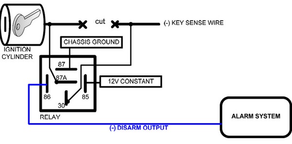

im going to put a remote starter  in a 2005 toyota corolla . everythings i red on the sheets , i have no problems . the only thing is im not sure how to hook the disarm wire in the keysense of this car. can you help me ?

disarm with key sense -- posted image.

Corollas don't have factory alarms, unless it's a dealer-installed one.

Hey I just saw that you're in Canada, so maybe it's different there. You should check to see if the car has an alarm or not.
1. Open a window.
2. Close hood, trunk, and all doors.
3. Lock with factory remote, and leave the car alone for 30 seconds or more.
4. Reach inside, unlock the door by hand, open it, and see if any alarm sounds.
