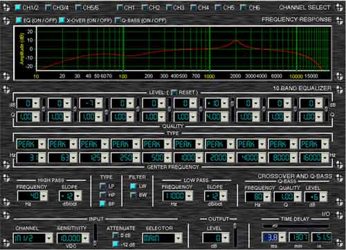

Last I knew Eclipse offered a nav with great DSP features in their line up, but I am not up to date on this years product. Audio control has great digital processors with time alignment that use RCA in puts and out outs, and Zapco makes a killer piece that can use digital input as well as RCA or balanced inputs. The cool thing about getting a dedicated out board processor is that you are free to pick and choose your headunit and amplifiers. Be aware though that many (most all) video/navigation units have inferior digital to analogue converters and weak pre-amps. This can ruin your best efforts.
If you can find a head unit with digital out and you get the Zapco processor you will be able to achieve one of the best possible signal paths, and precision control over every speaker in your system. All adjustments are performed by software on your PC.
This gives you a great visual tool. You can actually see in real time what modifications you have made to the signal. This makes things easy to understand.
How to Achieve Awesome Mid Bass. - Page 2 -- posted image.
In the time alignment (lower right hand corner) the software even calculates distance for your adjustments, making it a snap!
But that’s just one of many great possible options.
