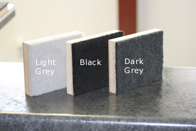

There is this carpet that elemental designs has that I really like. The only thing is that it is fairly expensive to buy. Does anyone know of somewhere that has a similar carpet??
sub box carpet -- posted image.
I already used the latex backed carpet from partsexpress but I wasn't to thrilled with it. The glue leaked through and the carpet wasn't as nice as I expected.
One other question, what do you guys use for glueing on carpet?? I used 3M 90 spray but it didn't seem to hold so tight around the corners. I used some contact cement on the parts the 3M spray didn't hold and that seemed to work well. I just wanted to know if it was good to do the entire box with that. I read somewhere that it was a preferred way to put on carpet.

I ended up using contact cement. I painted the carpet and the box with it and let it sit for a little bit and then put the carpet on. It worked really well and i will definetly try it next time I do an enclosure.
It ended up working out better then the 3M spray because it was a large enclosure and it would need a couple of cans. Considering how a can of 3M spray is $10-$13 and the single can of contact cement i used was $6.50 I would definetly recommend it. It also didn't soak throug the carpet and it stuck better then when i used the 3M 90 spray.
