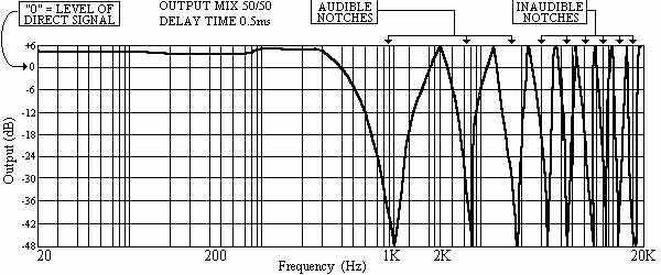

In my opinion you have one of the best tweeters ever engineered specifically for mainstream car audio. The trick to avoiding that harsh sound is to always be aware of comb filtering and take steps to avoid it. Comb filtering is when a change in the speakers phase occurs at a lower frequency that causes a ripple in the response. This ripple will repeat its self over and over again as frequency rises. In other words a simple alteration like poor equalization or reflective surfaces that effect 3khs can have horrendous effects at 10khz.
focal tweeter tuning -- posted image.
Here you can see the effects of comb filtering on what would otherwise be a flat smooth response. A shift in phase at 1khz causes problems throughout the pass band. This can be caused by tweeter location relative to the mid range, incorrect crossover frequency, incorrect equalization, and other things.
Incorrect crossover frequency selection is a common cause of comb filtering. Your tweeters have an Fs of 1955hz. The accepted rule of thumb is to always crossover tweeters at a minimum of twice the resonant frequency using a 12db crossover. This would be 3910hz in your case.
After you have established a good crossover point for your application, the next step is to equalize if you have the equipment. Always start by equalizing lower frequencies first and working your way up. This actually applies to all speakers of all types. If you randomly equalize you run the risk of inadvertently causing comb filtering. Then you will find your self trying to equalize a problem that you actually caused. Comb filtering can be masked by the way that an RTA displays its information. This is why many people don’t trust these machines. They don’t realize that they are equalizing improperly, and that the RTA lacks the resolution to display that. Like I said comb filtering can be avoided largely by taking steps to avoid it. The correct tool to use to view it in the event that you think it is the source of harsh sounding highs is an FFT analyzer.
All car audio systems suffer from this and most suffer a lot. I stress this because this is the absolute largest cause of bad sounding highs.
