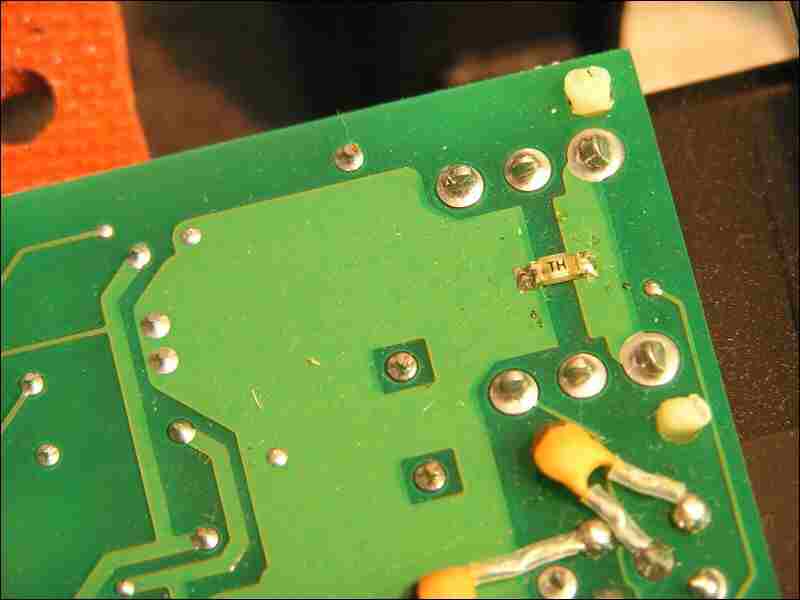

Unfortunately for you, Kicker (just like Pioneer does on their headunits) puts a fuse in the shield path of the RCA shields. If your ground wire comes loose while the amp is playing, it will cause the fuse to blow. You need to use your ohm meter and check the resistance from the RCA shields to one of the middle speaker connections. This should be 0 ohms. I am betting it is a lot higher than that.

well i checked that what you explained to me, but it did not give me a reading at all. i wonder if perhaps the connection inside the amp for the rca inputs it bad. if the connection is loose i would assume that would be the reason for all of the random noise, and it would explain the why when i tap or touch the amp the subs make noise.

If you got no reading at all your amp is suffering from exactly what I said earlier.  Just to confirm that this is the problem, connect an extra speaker wire into one of the middle speaker terminals, either left negative or right positive,  touch the other end to the outer part of the RCA jacks, this should make a slight pop and then the noise will go away.   I actually fixed one today and I took pictures of where you need to install a jumper.  If the wire solves your problem, let me know.

This picture is of the fuse itself.  It is on the bottom of the board, the 6 connections nearest to the fuse are the RCA jack. The fuse has the letters  TH on it.

If you do not want to order a fuse, it can be replaced with a 1 ohm 1/4 watt resistor.      This repair can also be done on the top of the board.    It will probably be a safer repair if done on top of the board.  You won't have to remove the board from the heat sink.

can you tell me what are the info for the fuse. volts? amps?
or would it be perfectly ok to replace it with a resistor?
Platinum - Posts: 13,726
Posted: January 16, 2008 at 7:24 PM / IP Logged
It will be perfectly OK to replace it with the resistor.
