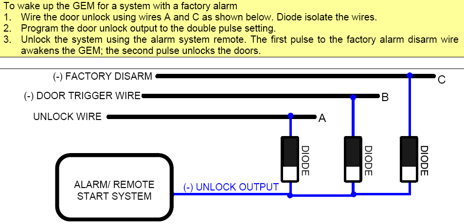

Posted: January 16, 2008 at 9:56 AM / IP Logged
will idatalink wake up gem -- posted image.

This is the "manual way" to wake up the BCM, it really does not answer his question....
