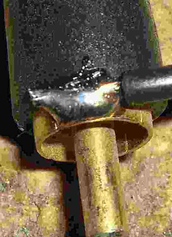

Platinum - Posts: 13,725
Posted: January 21, 2008 at 5:49 PM / IP Logged
Try taking a length of small wire, strip both ends of it.  Ground one end, and touch the other end to the shield of the RCA cable that goes to the amp in question.  If this makes a pop and then the amp starts acting properly, then yes this is your problem.  It is not an easy internal fix on the D3.  This is just as effective and easy to do.   The other end of the wire in this picture needs to be grounded.  This needs to be done behind the radio, not at the amp.    Picture won't upload at the moment  I am going find a thread with the pic in it.

Posted: January 25, 2008 at 8:54 PM / IP Logged
Thank you guys.  I followed the directions and picture sent to me by i am idiot and everything is working perfectly.  My solder job was not as nice as the picture but it is solid and works.  Is this common on pioneer radios?  I love my D3 I now only have 3 complaints the rca deal, ipod interface, and I can barley get it in my truck dash because there is so many damn wires but just minor compliants.  Do you guys usually solder your wiring harness connections?  Thank you agian you saved me hours of trouble shooting and cusing.

Glad to help   Let's see if the picture will upload today.  Just in case somebody else stumbles across this.
amp problems feedback coming through sub -- posted image.
tedmond
Gold - Posts: 4,610
Joined: January 06, 2007
Location: Ontario, Canada
Posted: January 26, 2008 at 6:35 AM / IP Logged
looks like a cold solder joint =D but i have tried that befor and it sure does work. why does this only happen with pioneer? i assume they would fix the problem in their newer decks but just recently installed a 4900IB and still got noise.
