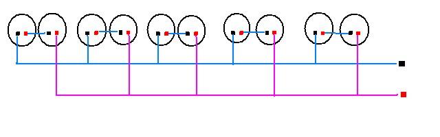

Can't figure it out with the calculators, tuscani?  Here's what you can do if you can connect the amps so that you have the equivalent of one amplifier instead of two:
10 can be divided by 5 or 2.  You have to arrive with an equal configuration of sets that when added together amounts to 10 subs total (you can't have 3 or 4 subs per set, for example).  It is almost always necessary to figure series/parallel wiring with this many subs, so divide the subs into sets of 2 each and you'll have 5 sets.  Wire each set in series, then parallel the sets.  Impedance is about 1.6 ohms.  Each sub will get maybe 60 watts.
ten 10's to two 1 ohm stable amps -- posted image.
