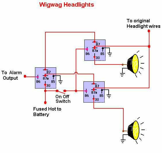

i been trying to make my head light flash one at a time when my alarm gose off i want the right to flash once the the left  then the right and so on i am usein the horn output from the alarm does any know or have adiagram on how to use relays to do this

relay to make my head light flash -- posted image.
