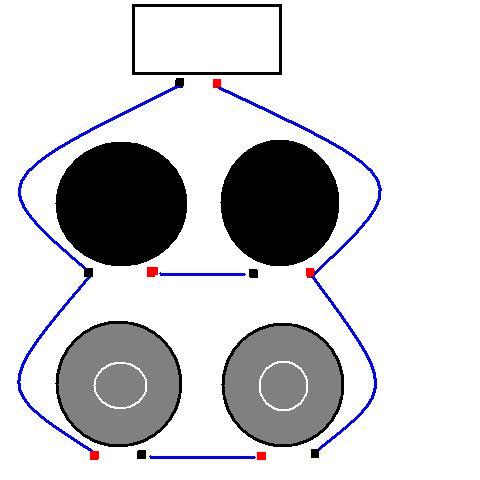

Here's a diagram.  The two subs on the left are a series-wired set (a normal and an inverted), and the two on the right are also a set.  Each set amounts to 4 ohms.  The two sets are paralleled for a 2 ohm impedance (shown with the curved lines).  The wires shown at the far left and right will go to the amplifier.

Yea I had to draw it myself before I could figure it out!
I had no idea you could wire that way.  huh.
Thanks, stev.

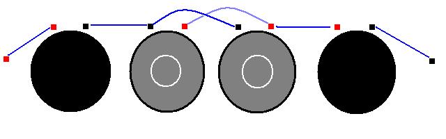

Shown below is a different way to achieve the same result.  Here, the series-wired sets are combined as normal / normal and inverted / inverted.  So since we are paralleling a normal set with an inverted set it's the parallel wiring, rather than the series wiring, that differs from the norm.  It is a series / parallel wiring scheme (with curved lines representing the parallel wiring.

And good reason for that, sedate.  You can't.  That is some messed up wiring.  4 subs on a mono amp? -- posted image.

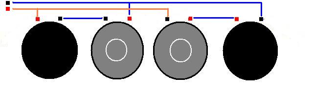

After I had some time to sober up I looked at it again, tried to figure out impedance, and realized it made no sense.  I erased the wiring and rewired that diagram correctly.  It should look like this:
But still, it's more complicated than it needs to be.  Use the second diagram I posted and disregard this configuration (where a normal is paired with an inverted) altogether.  Just pair the subs normal with normal and inverted with inverted like the second diagram shows.  Sorry for the bad diagram.

THAT'S the one! 4 subs on a mono amp? -- posted image.
