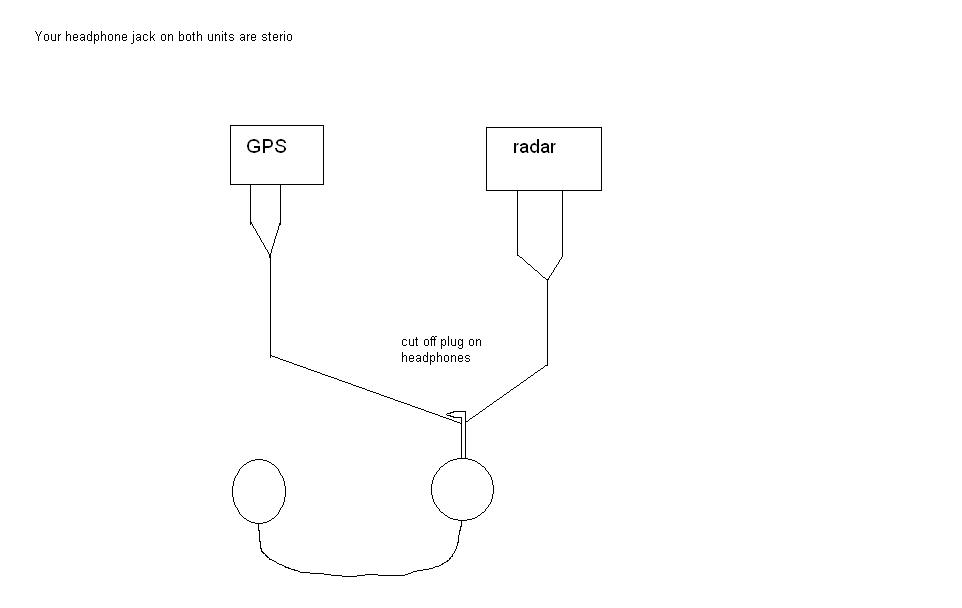

Both of your units have a sterio jack. What youll need to do is get 2 sterio cords. One to plug into each unit. The other end youll cut. There will be 2 wires in each. You will splice those 2 together. On your headphones, there will be a jack. Cut it off. There will be 2 wires. Wire one wire to the one unit, wire the other wire to the other units wire. You can also use mono type cords then you wont need to splice those wires together. Hope this helps:
connecting gps, radar audio to headphones -- posted image.

Wait. Where are the rca's plugging into?

these headphones you are talking about, are they made for the car? Like are they wireless and have a reciever that has RCA jacks?
