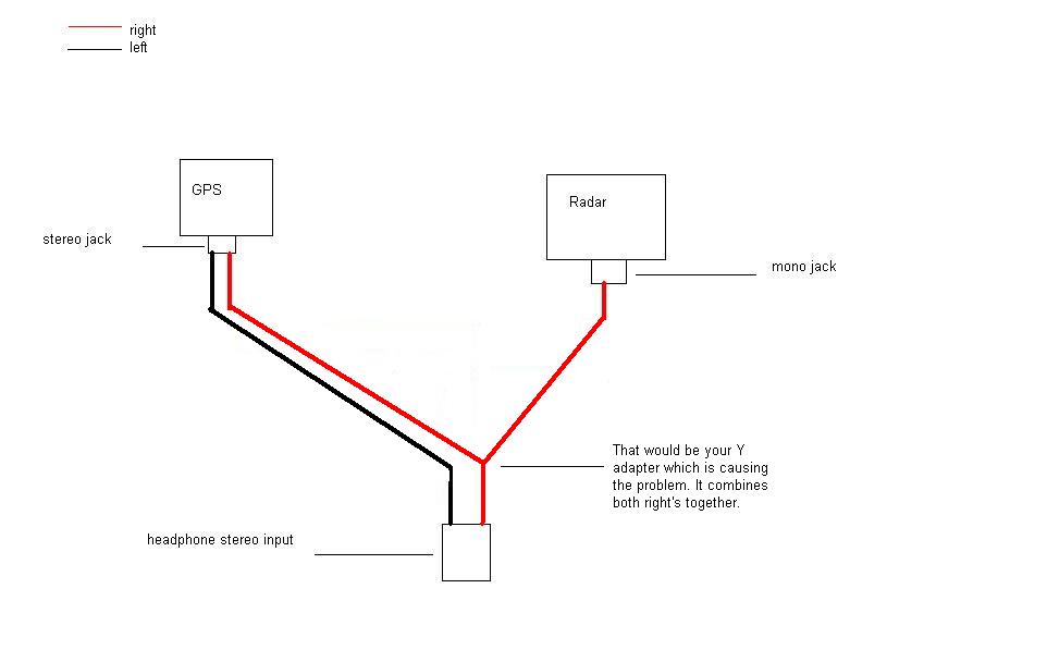

If you were to just take 3.5" Y adapters and get the stereo cords this is how it would look:
connecting gps, radar audio to headphones - Page 3 -- posted image.

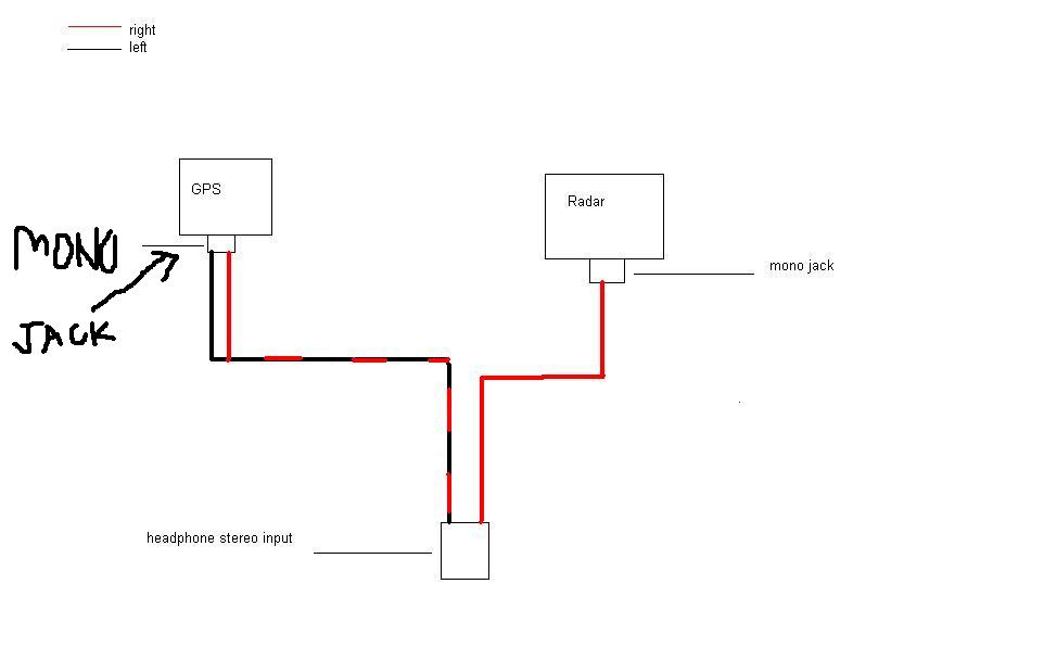

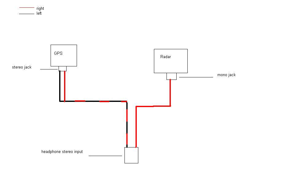

This is how it would work if you spliced:
