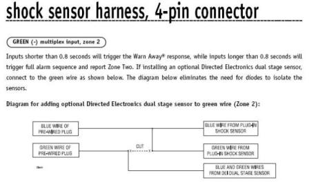

I'm currently installing a clifford rsx3.5 alarm in my vehicle. the sensor's I plan to use are shock, tilt, motion, glass break...all of these are dei. I'm not sure on how to wire them up.
Could someone please provide a diagram with all diodes included.

Here's how you add a second sensor with the external shock as per the install manual page 33. This will report a ZONE 2:
clifford rsx3.5 -- posted image.
For an additional sensor that has a multiplexed output, connect it to the blue wire in the 12-pin plug. Only one sensor on this wire. Make sure there is nothing else connected to it. This will report a ZONE 4.
For additional sensors that have a simple single wire ground pulse out, connect them to the gray hood pin switch wire. This will report a ZONE 1.

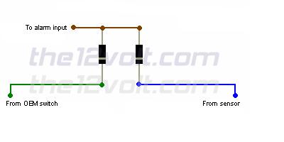

So what needs a diode

Shock and motion are in the shock port as shown on diagram in my first post. No diodes needed.
Tilt: Put the tilt on the blue wire in the 12 pin plug. Diode isolate if you're using the OEM trunk pin switch on this wire as well.
Glass break: Put the glass break on the gray. Diode isolate if you're using the OEM hood switch on this wire as well.
Here's how to diode isolate:
