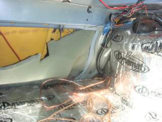

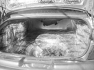

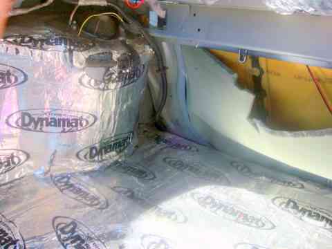

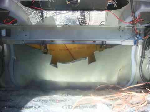

Okay i sold my old system out of my 1999 buick century and now i want to make my own setup. this will be my first time attempting to fg so i hope it all goes well. alright now for some pictures. sorry about the B&W its the only way i could resize it and get it under 30kb =/
trunk with clean slate -- posted image.
how would i go about doing my trunk? im thinking 2 12" kicker l7's sealed, mated with a hifonics amp.
should i lay mdf on the bottom and fiber up the curves? how about that old drynamat haha. should i take it out?

any info will help out GREATLY. Thanks guys

Don't worry about B&W as long as we can see what you are doing, that's all that really matters at this point
~snip
~snip~
~snip~
How you go about the project is up to you but I would keep the Dynamat in, unless you are willing to scrape and clean that off and redo it all over again. If anything I would add onto it, or heat it up and make sure that all bubbles are gone from the DM.
