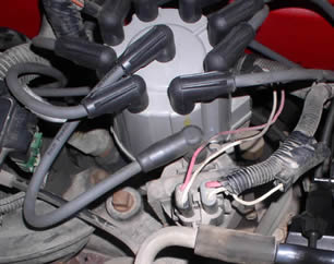

I have a 1992 chevy ck 1500 pickup that I am installing a remote start / keyless entry system on.  I am trying to find the correct wire to on the coil to tap into for the tach wire hookup.  The manual says I should have 1 to 6 vac on the correct wire.  I checked both white wires on the coil and the both read 10 vac.  This is more than the manual says, which has me confused.  Also is there a preferred way to tap into the correct wire so as to not cause problems now or later?

Use either one and test to see if the unit accepts the signal. Most systems require a minimum of 6 volts in order for a proper tach learn.
