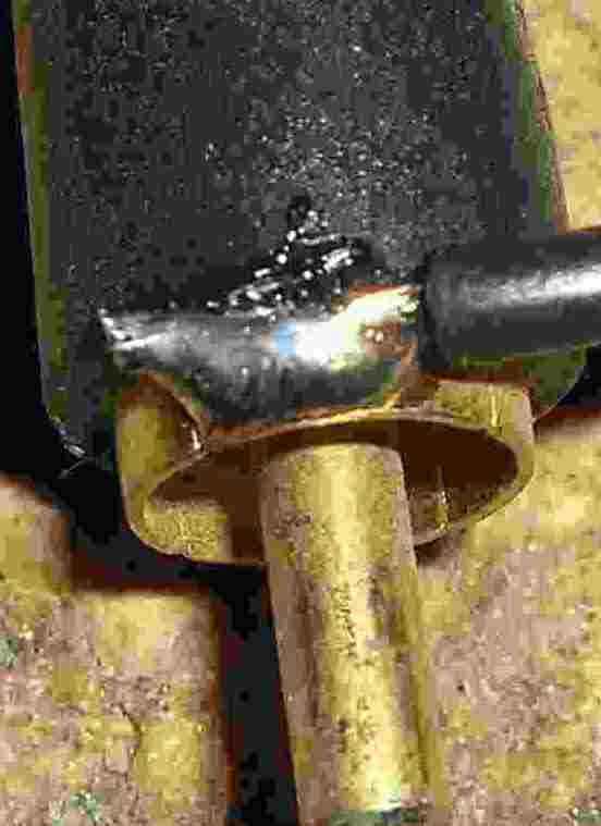

You have a blown surface mount fuse on the circuit board of the radio.  This fuse protects your radio in case a 12 volt wire touches the shield of your RCA cable.  The simple fix is to solder a wire to the outer part of one of the RCA cables that go to the sub amp and ground the other end of that wire.   The yellow wire in the following link really needs to be a black wire and you need to ground it to wherever you grounded your radio.
alternator noise in subwoofer? -- posted image.
http://bcot1.com/images/rca/IMG_9227b.html

Posted: February 29, 2008 at 8:12 PM / IP Logged
hey i am an idiot, i remeber u posted a blurry pic or at least i think u did. well it had a cold solder joint, but this one is sure a pro solder job, nice one !

Posted: March 03, 2008 at 8:06 PM / IP Logged
Cold solder joint or effects of compressing a picture so it will post here?
