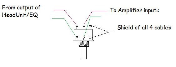

If you want to build a seperate volume control, the following picture will help you.  The potentiometer in the drawing is available at radio shack, the part number is 271-1732.  You will also need a project box to mount it into. and a patch cord to wire it up.  This will be a volume control, you can turn it all the way down. This provides no boost or additional gain.  better performance from a bass knob? -- posted image.
The 3 connections on the top row will be left.  The 3 on the bottom row will be the right channel.   I will try to dig one up and take a picture and post it.

I truly appreciate the replies. Basically, can I change the pot out to a different one? will one give more of a volume range (or even, more of a "muting ability") than another? Another way of asking the question would be, if the limits of attenuation on the LPL44 are what I am currently experiencing, is there any way to modify it so that it attenuates the volume more or is "what I see, what I get"? I don't want to make a new bass knob as what controls the amp through a standard phone line with the pot, connected to the amp is efficient. In fact, for all intents and purposes, whether or not I am having bass out put or if I am trying to attenuate vocals on the same amp may be irrelevant.

Thanks for your reply and I see your point: Basically, this is the limits of the sub-knob circuitry inside the amp. I take it that using the design you provided, I could do what I want to do--go from wide open to completely mute.

Yes, the existing knob simply references voltage rails INSIDE the amplifier on the input buffers - semi-complicated - but that's effectively what it does. By "changing" the resistance on one or two resistors in the input stage, you are effectively "changing" the gain, without touching the knob on the amp. Most amps' remote knobs simply parallel with the internal gain potentiometer, some do not, however.
Yes. The design posted by i am will be an additional *in-signal-line* volume control. When installing it, turn it all the way up (zero attenuation) and set your gains as usual. You will probably be able to completely remove the PG remote knob, as well. Unplug it (and without removing it from the car) test that theory, but I am betting you'll be fine without the PG part.
