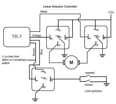

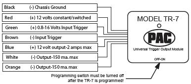

I will be using pac tr7 to operate my power folding mirrors
My mirrors have a + and - when giving normaly they open when switching polarity they close
I want to use the pac tr7 since it can time them since they dont hvae a relay
This is the sequence i need lock trigger-pac timer-mirrors
then same thing but with the + and - reversed they have a diagram on their website for linear actuators but im not sure if its the same
can you guys edit how i would need to conect everything thank you
PAC TR7 Relay -- posted image.
as you see on the bottom there is another relay for a switch but i dont want to use a switch
also my lock and unlock triggers are + thank you
