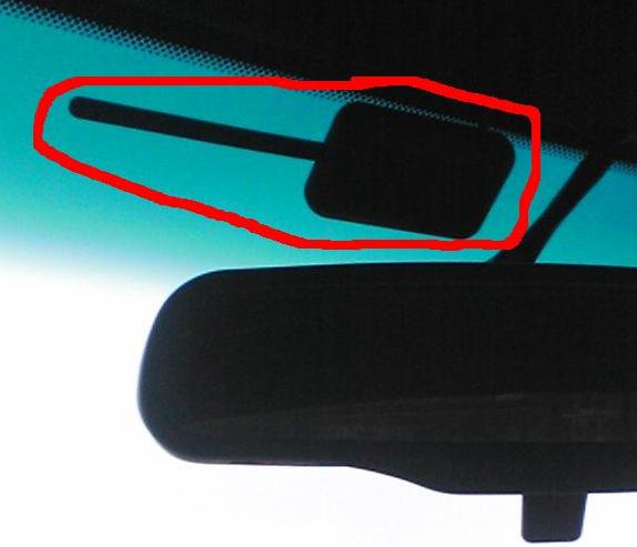

so if my antenna was here, this would be bad?
increasing alarm range cs 2013fm -- posted image.

yea, i would never place it there. put the antenna facingdown below the tint band.

would it be ok to put it below the tint band, but on the driver's side of the windshield? Pretty much top left corner of the windshield just below the tint band?

oh and what exactly did you mean by 'face down'?

you can put it anywhere along the windshielf if you like. When i mean face down. Make the antenna part point vertically. right now its horizontal.

I moved the antenna, but doesn't seem like the range has changes.
