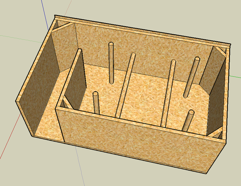

Hey guys whats up...finally stopped being lazy and started my enclosure build.
Sub is an Elemental Designs 19Ov.2.
6 cubes tuned to 40Hz w/ 112.5 in^2 of port area.
Sub up port back.
exploder build -- posted image.
Heres the start of the build
Not really my competition enclosure but a daily 6 cu ft tuned to 40Hz with 112.5 sq inches of port area.
Not finished yet of course

I like your build depictions, particularly:
  • use of a speed square and simple toolbox C clamps
  • corner bracing, and
  • use of dowel rods for effective, space-saving bracing
You might consider completing the curved lines approach throughout the enclosure by smoothing the edges of the port wall end, and by routing a radius on the back side of the driver mounting hole.  Nice thread;  it'll be fun to watch this through completion.

I still plan on routering/sanding down the inner port edge so it is smooth and round and not a sharp edge.
I haven't had time to go buy some 90* corner clamps so I made due with what the extra speed square that came with my dewalt cirular saw. Does a lot better than my old garage sale skill saw with a dull blade lol.
Well I could fit a 35Hz transmission line in the back but it would be 4-5" away from the rear hatch. I may experiment with an SPL TL later on before the MECA competition in April.
With this I am going to build a false floor with my amps underneath.
Thanks for the comments guys.
