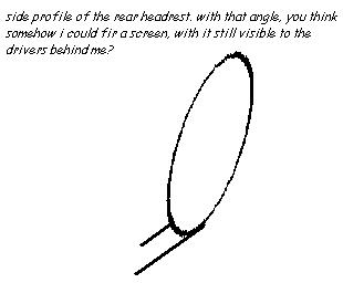

Is it possible to install screens in th rear headrest of a 2002 Chrysler 300M? Even with the degree of the angle that the post's are at. at?screens in rear headrest 2002 300m -- posted image.

there a few screens on the market that let you adjust the vertical viewing angle, i think dei makes the one im thinking about.  your other option is to build a pod for the unit and build out to compensate for the OEM angle.   i can usually make the screen viewable for the the passangers in the back seat with out using these methods but then again it all depends on what the customers usual driving seat high/slant is.

thanks man. ill try that out!
