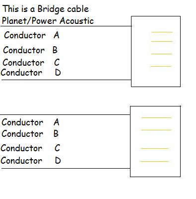

Not sure on the audiobahn amps but the wire for planet audio / power acoustic class d amps are a 4 pin phone cable wired backwards on one end. You will need to get 2 6 conductor telephone ends and show this picture to someone that has the equipment to make a cat 5 cable.  Notice the difference in the cables vs. the standard phone cable.audiobahn amp 18001dt bridge cable -- posted image.
Platinum - Posts: 13,725
Posted: March 19, 2008 at 7:03 PM / IP Logged
Posted: March 19, 2008 at 7:04 PM / IP Logged
Your amp may only accept a 4 pin handset connector.  Bring your amp when purchasing the plugs.
