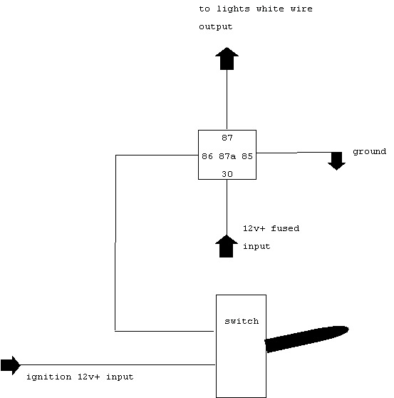

Hi i got a xtc 4 light bar on the roof of my hummer . It has 2 wires coming out a white and a back wire .
I need your help on how to hook this up with a relay and a switch . If you can draw me a diagram i wil hel me tremendosly . Thank you RKI

The black is probably for a ground and the white will be positive when you want them to go on. Run both wires into vehicle under driver side dash. Ground the black to a factory ground.
To wire a relay and a switch you will need to get a 30a/40a relay spdt or spst whichever you can find, either will work in this application. Then a good toggle switch of your preference. Then I would wire this way to have lights on only with key on.
pin 85 ground
pin 86 switch contact
pin 30 to 12v+ source with an inline fuse rated to 30a
pin 87 to white wire to lights
second contact of toggle to an ignition or accessory source
2003 - 2006 Hummer H1 Ignition green at ignition harness
2003 - 2008 Hummer H2 Ignition Pink at ignition harness
2006 - 2008 Hummer H3 Ignition WHITE/ green or dark blue at ignition harness

Techman thank you  but i'am a little confused , What i need for you to tell me is this. I need to hook up my lights only to a switch and relay . To turn on and off the the lights with the switch . If you can get me a diagram or something i'll thank you for it . sorry for the incovinience, RKI

2 wire roof light hook up -- posted image.
this is as good as I could do with my old print shop program

Techman93 you just made my day i thank you very much and if you ever need residenial central a/c or appliance technical advice all you got to do is holla back to me . Thanks again RKI

Your welcome. Remember to also ground the black wire from lights. It can be done to the same ground as relay.
Hope that made your install a tad easier.
