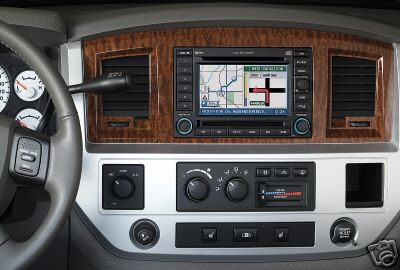

Platinum - Posts: 13,725
Posted: April 10, 2008 at 8:43 PM / IP Logged
07 dodge ram radio bezel trimming? -- posted image.
