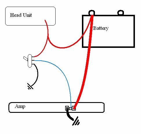

Okay, so my question doesn't actually follow the thread, but could you use this same technique for a remote turn on wire for an amp? In case I'm not being clear, I've included a ghetto picture:wire a relay to mute spkrs? -- posted image.
It makes sense to me that you could, but I have to ask.
Platinum - Posts: 13,725
Posted: April 06, 2008 at 10:46 PM / IP Logged
You could do that for an amp, but I would not reccomend getting the power source from the battery.  If you forget to turn it off your amp will stay on.  Feed the switch with the amp remote wire of the radio.
techman93
Silver - Posts: 591
Joined: October 28, 2006
Posted: April 06, 2008 at 10:55 PM / IP Logged
Or as a last resort an accessory or ignition source that will turn off with ignition. I would suggest a low voltage trigger may work in that application and it could sense an audio signal as a turn on. Only bad thing is in between songs on a CD it may shut the amp off.

theetimurban
Copper - Posts: 126
Joined: December 30, 2007
Posted: April 06, 2008 at 11:09 PM / IP Logged
Ah, that's what I was afraid of, but it's not for me, I was planning on getting a small set up for my dad for his birthday, and he didn't want an after-market head unit, but since him and my mom swap cars all the time it needed an on/off switch since my mom can't stand bass, in anything, and I mean anything, don't ask me why, I couldn't tell you.
Any other ideas?
