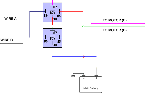

Do you think this might be possible? Because this way I could work it directly to the battery, and keep the existing switches!
