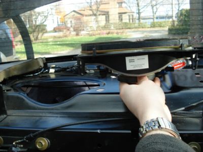

Can't remember if they're there or not but just make sure that the enclosure clears the torsion rods that hold up the trunk lid. If your looking at removing them or if they are not there then disregard this post.

Yes, absolutely on the torsion bars, I agree. For whatever reason they put a harness type thing for the 6x9's that will help me gain the additional space I might need. Check it out, this is from my 6x9 install that will be removed.
