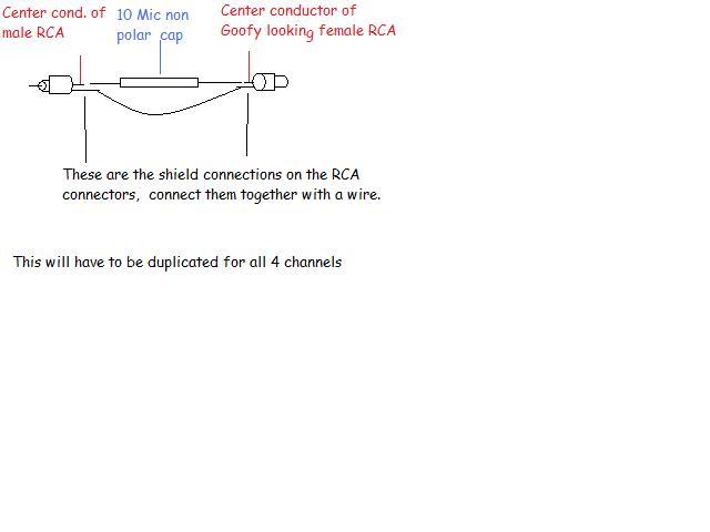

Platinum - Posts: 13,725
Posted: April 21, 2008 at 3:56 PM / IP Logged
ford amplified system turn on pop -- posted image.
