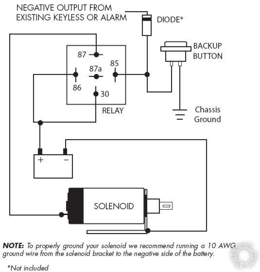

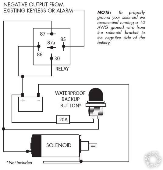

Hey guys, I have been wokring on my CRX trying to get the door poppers done. But however, I Shaved the handles on the outside of the car and the inside. What I want to do is have buttons to open the doors from the inside. The drivers side I want two buttons One for the Drivers Side Door and the other for the Passenger side door. The driver side door should be easy. I am unsure how to wire up two buttons to one popper. I have Some Wire Diagrams from Autoloc... Help would be apreciated.

If I am understanding you correctly, it sounds to me like you want 3 switches all together. 2 in the drivers door, and one in the passengers. If this is right all you have to do is add another wire to pin 85 on the top diagram and run it to the second switch on one terminal, and then run a wire to ground on the other terminal of the switch.
