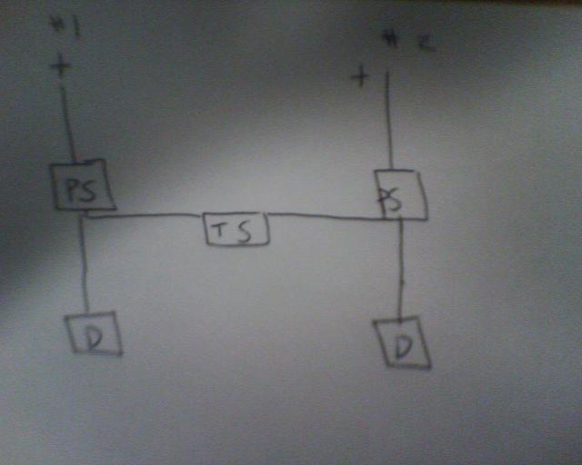

kinda under stand what you are say so the spdt is a toggle and wire that switch on the ends where the devices connect to the ends of the toggle not where  the power source is.
d is for device
adn ts is toggle switch
ps is power is switch

Your picture will work,  Just remember that when the Toggle switch is on, either push button switch will now work both devices.
