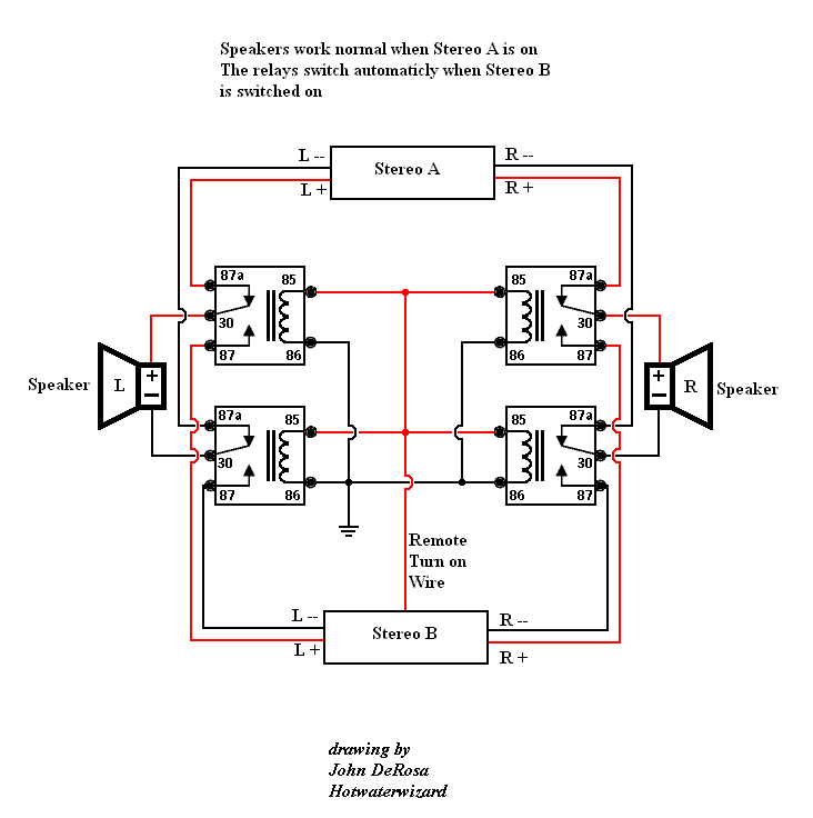

Hi, was wondering if anyone knows a way to switch audio from one stereo to another. I am trying to build a sound board with 2 stereos and 2 speakers. The idea is to be able to turn  on the second stereo with a switch, and have audio cutoff  from the first stereo then go to the second stereo without any feedback to the first stereo. Any ideas  would be great, Thanks.

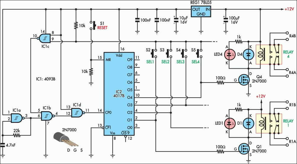

relay_selector.gif Click Here
Here is a circuit for multiple displays. For 2 you could just use a couple of relays for each channel.

relays to switch between 2 radios -- posted image.

congoman
Member - Posts: 29
Joined: February 26, 2003
Posted: May 22, 2008 at 12:36 AM / IP Logged
Hey Thanks for the diagram. I haven't tried this yet but once I get a chance i will followup with results.
